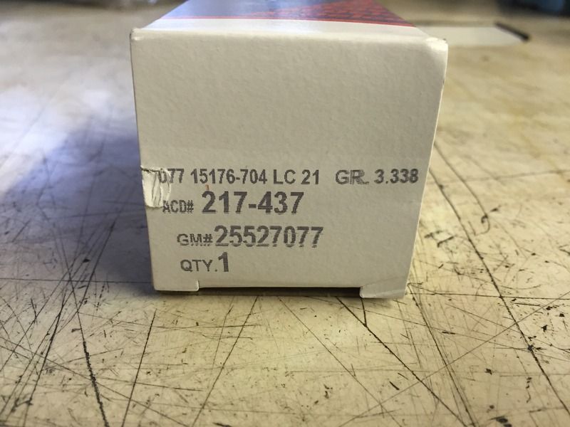

A fair bit of googling led me to an AC Delco item on Amazon US of A. AC Delco is the parts division of General Motors, and these stepper motors feature on quite a number of their 80s and 90s models. What you need is a 217-437 Fuel Injection Idle Air Control Valve Kit. It comes with the sealing washer and is identical as far as I can see to my old original item which are listed at £180 or so from the usual suspects. It cost me about £55 including delivery from here:
https://www.amazon.com/gp/product/B000C ... UTF8&psc=1

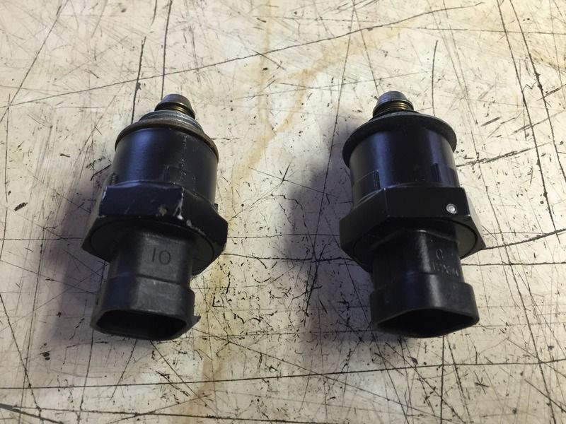

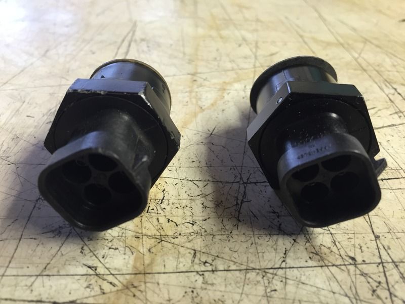

Hope that's a help to someone. Photos below comparing it to my old one.
